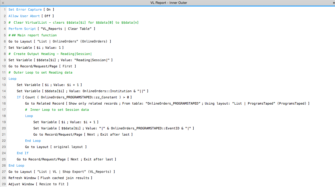

The simple BFI approach would be to run an Inner and Outer loop - Outer loop to capture the Reading records, then an inner for each of those records to capture their related Sessions records.
For presentation, I would put one set of data in one data point in the row, and the other in another, then use two fields on the final VL report.
Below is a simple version of a script to create an array $$data[$i] to be read back on a Virtual List layout - it has two data points for each row, one in position 1 for the Reading, and in position 2 in a new row for each associated Session record
Hope this helps
Thanks for responding @webko.  That's what I ended up doing.  But I do want to revisit it tomorrow and consider your script. My script is a mile long!  Yours looks much more compact
It's a simplified script, and there is also the setup on the VL table to read out the data that's not shown directly in this example....

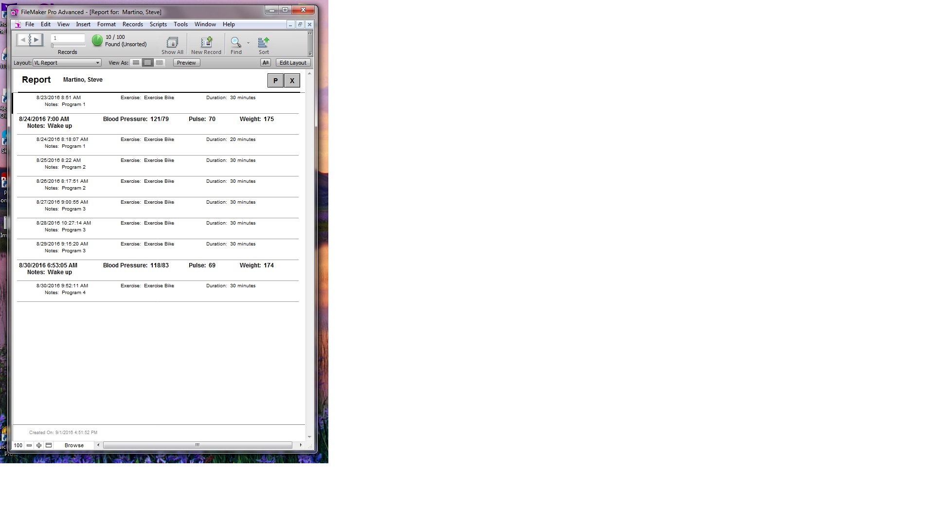

Here's what I ended up with, and the resulting report.  The script is long and ugly, so if anyone wants to offer any suggestion I'm always willing to learn.
I can never figure out how to go from the script to the forum.  If I try a screen shot its never readable, so I attached it as a PDF
Steve

@Steve Martino - I think that script can be cleaned up a bit - your global vars are each for an entire Column - which can go astray if there is a missing value somewhere down the list.
Thanks to people here, I tend to use a row approach based around $$data[$i] that gives one row of data for every iteration of $i, that then gets split into the individual values in the final report.
Which then also allows the formatting to be applied at a field level in the final report, rather than embedded in the data, as you can decide exactly where in the row certain data points actually exist (i.e., you can pad data into the 4th or 9th or 21st cell, and then format that cell accordingly...)
