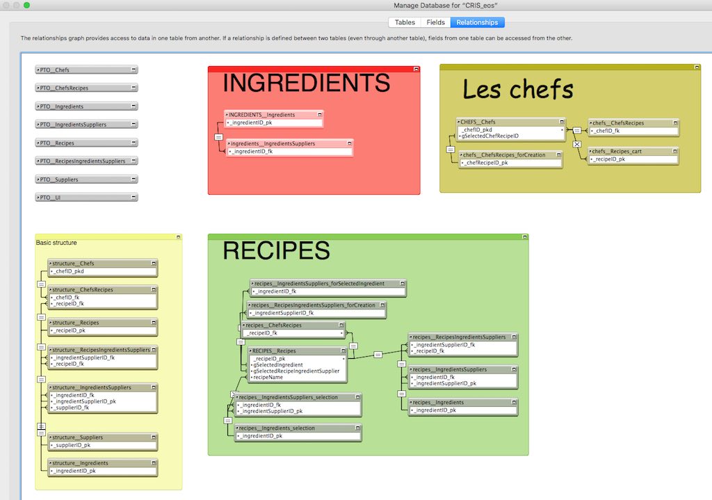

Looking at your database, unfortunately it's wrong...and really wrong.  But all is not lost as you didn't get too far into the process.
First you should research FileMaker Recipes.  There may already be a solution you can either use, or look at to understand data modeling, scripts, relationships, etc.
This type of database may read more like an Invoice database:
INVOICES----<LINEITEMS>-----PRODUCTS
RECIPES----<LINEITEMS>------INGREDIENTS
You will probably need more tables than this, but this will get you started
So your first table is all your INGREDIENTS.  Just list them all, I would ignore quantities, unless you want to enter the quantities you purchase them in when you buy in bulk.  Doing so may help with a shopping list.
LINEITEMS will be your join table.  For starters, it can be a portal on your Recipe Layout.  You will have a primary key from RECIPES linked to a foreign key in LINEITEMS (one to many) relationship, and a primary key in INGREDIENTS linked to a foreign key in LINEITEMS, also a one to many relationship.
Your LINEITEMS table (portal) will have fields for quantites, as well as instructions (Instructions may need to be a separate table, but for simplicity sake just make it a field in LINEITEMS).  It will also have fields that will look up your ingredients, either by LookUp or Calculation.

Attached is a modified version of your file with a few of the errors corrected.
Steve mentioned some of your errors; including putting foreign keys in the Recipe table, instead of the Recipe_lines table.
Also, you had set up all your relationships to be cartesian relationships ("X" relationships)
That means "put everything everywhere." You don't want to do that.
