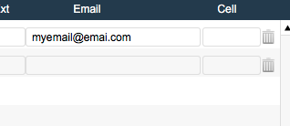

Find in Portal- Problem

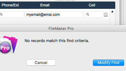

I have Contacts portal on Company layout. Now, I can do FIND in other fields of the portal but email field., I already checked inspector > Field Entry in find mode is cheked..
I have attached screenshots
Try putting it in quotes
Hah! it did the magic...thanks Steve..
Unfortunately, @ is a special symbol in find mode. Quotes works. Also changing the fields storage settings to Unicode (though then upper and lower case letters will be treated differently). It's a problem.
The problem here is that the "@" character is a special symbol in Find mode. And the solution is to escape it when you want to search for the actual "@" character - i.e. search for:
myemail\@email.com
