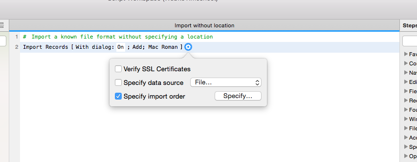

Well, you can _not_ specify a location, and you should get a prompt asking for the file.
