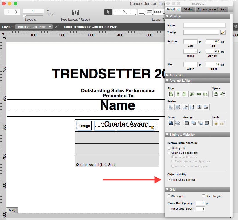

The objects are not printing because you have specified that they should not print.
If you want them to print, select them and then uncheck the "hide when printing" checkbox.
