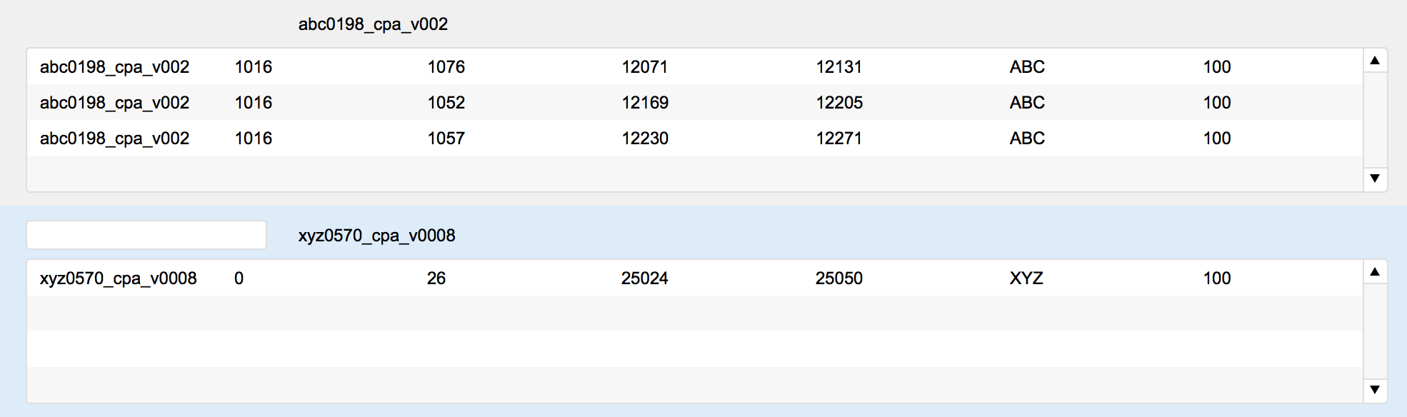

Basically I've got a layout that contains a portal to another table. abc0198_cpa_v002 and xyz0570_cpa_v0008 are the link to the other table (linked to the table by the first 6 characters)

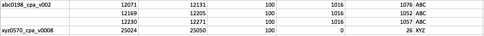

the problem I have is when I export this I get the following in Excel. I was hoping that the empty fields beneath abc0198_cpa_v002 would be filled with abc0198_cpa_v002.
excel_output.thumb.png.9374be865c447b386
I can get it to work by going to the related table, searching for those records (abc0198 & xyz0570), but I will fall into the same problem when I receive multiple records that relate to the same record in the other table. IE I might receive abc0198_cpa_v002 and abc0198_cpa_v005 etc.
That would be the correct path to take.
If you already have a found set in the parent table, you can use GTRR [Match all records in the current found set] to establish the corresponding found set in the child table.
I am afraid you've lost me here.
