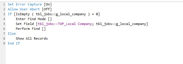

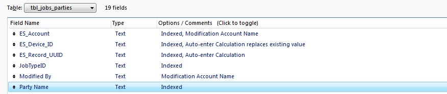

Attached are three files:
Script: The script used for search on main layout
Field def1: main calculation field used in find
field def2: base field on which the calculation field is based on.

Use Not IsEmpty
And make TOP_LocalCompany a text field with an auto-enter calc the same as the calc definition - I'm assuming the actual value doesn't really change very often

First, the calculation does not fit your earlier description. I am not sure if this is a mistake in description or in the actual design, but the calculation returns the first paragraph of the first (in relationship's order) related party's name. This is very different from:
On 01/27/2017 at 10:01 AM, FM_Newbie said:
The Search is mainly based on 'Search all jobs with same Pick up Address' or likewise.
Next, I made a test file with 2,000 parent (Jobs) records and 20,000 child (Parties) records and added a calculation field similar to yours. Searching this field produces instant results. I am attaching the file so you can test this for yourself.
