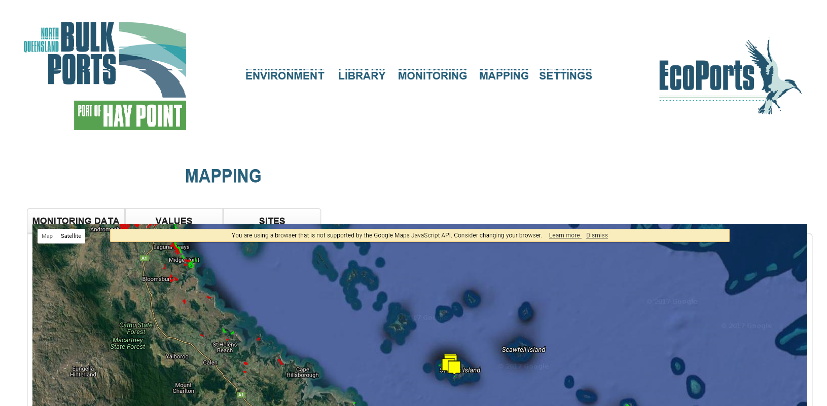

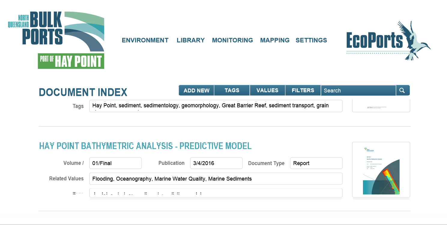

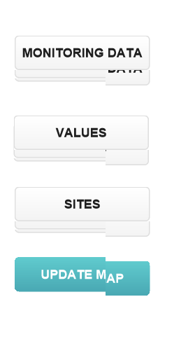

I used to use FileMaker on a Mac, but have recently switched to a Windows 10 computer. I was developing a database on the Mac, but since moving to PC I'm getting a lot of horizontal lines, blurred text and broken borders, images and buttons as I scroll. I've attached three screenshots as examples - these are happening on most layouts, most of the time.
