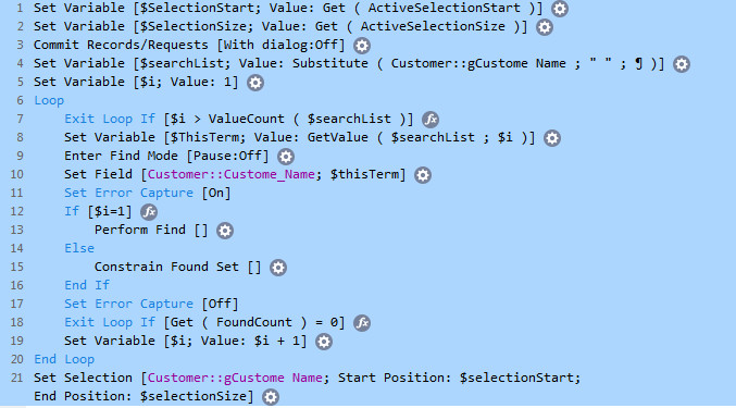

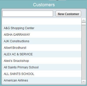

I am sure I’m missing something simple, but for the life of me I can’t figure this out. I have a database with tickets. What I want is when a new ticket is created I want to see a popover (see attached) then I want the user to type in the top box and as they type I want to filter the list below (a portal) and once they client is shown they would select it and a ticker is created for the client. I sound a script and modified to fit my needs but can’t get it to work. Can someone stretch a helping hand?
BTW the filtering is working but its not reflecting in the popover its reflecting on the layout.

Thanks, the main issue I am having is getting is to work within a popover.
It will work in the popover. The search method doesn't care whether your portal is in a popover.

for some reason the result are not reflecting on the popover only on the layout.
Maybe just a typo.
Take a look at steps 8 & 10.  You set a variable $ThisTerm, then in step 10 you set field with $thisTerm.

BTW, if the typo is the reason, here's where the Data Viewer & Script Debugger are you friend.  As you step thru, you would've seen the variable not being set.
