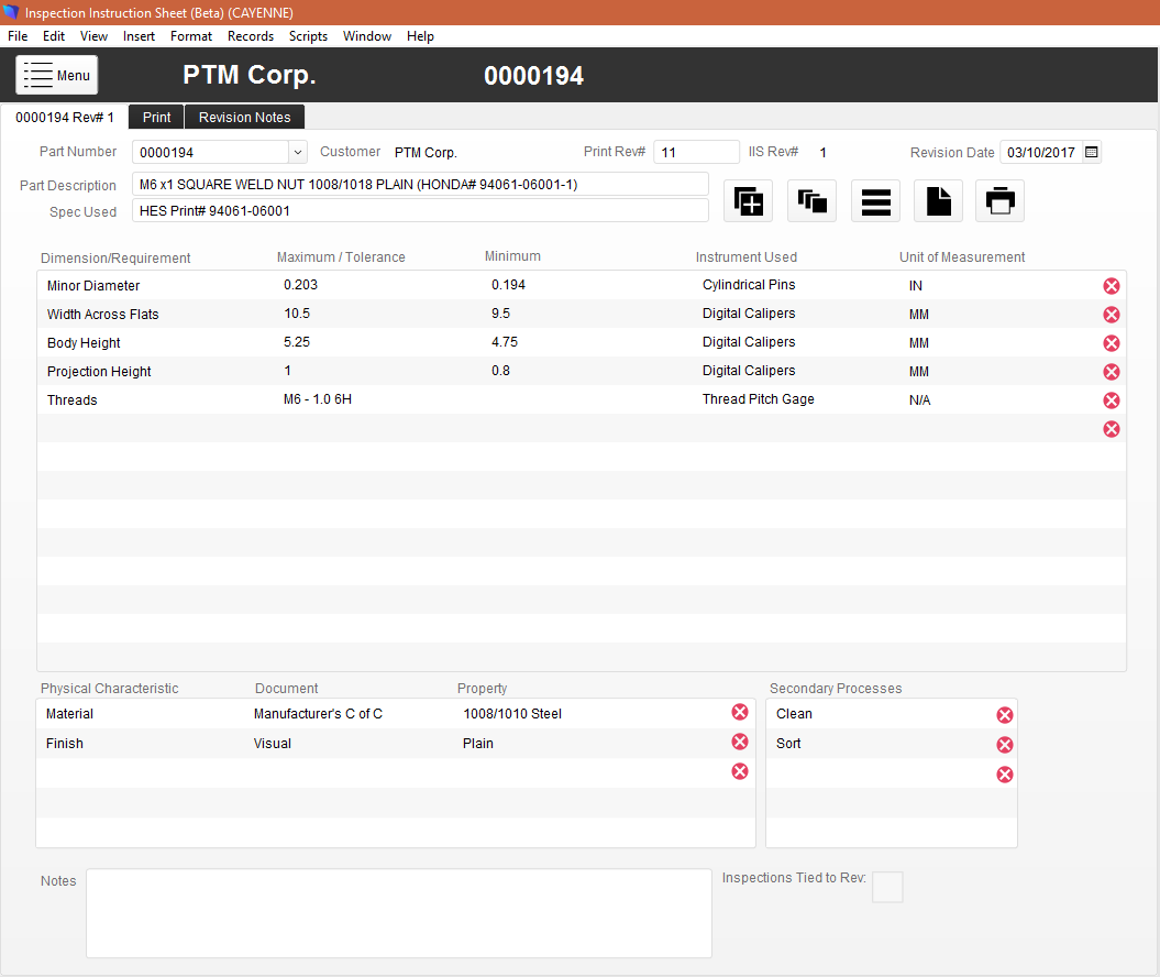

Here you can see that I do indeed have 0000194 as a record in the Revisions table

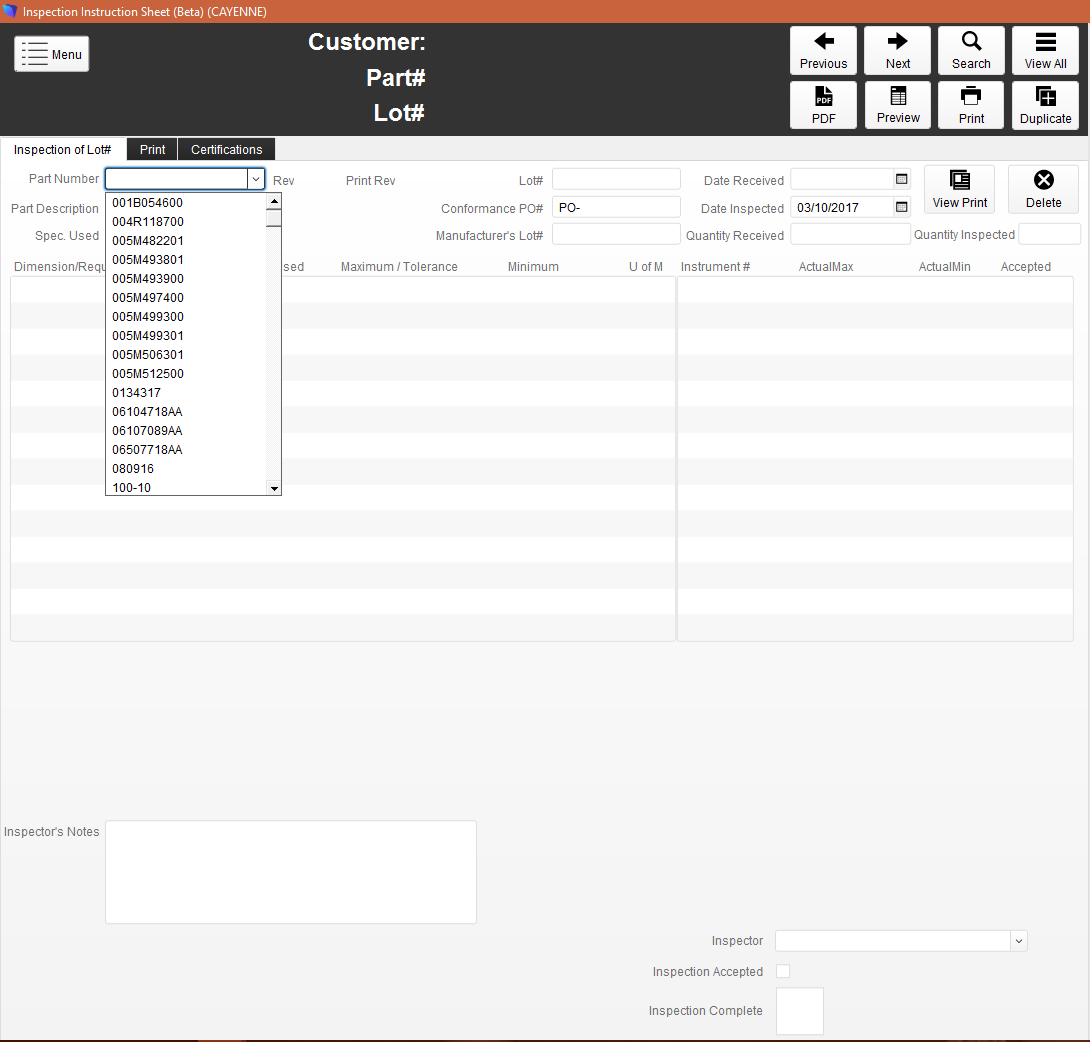

But when I go to use my value list, it is non-existent:
However, when I change the part number to "000194" it shows up just fine.
