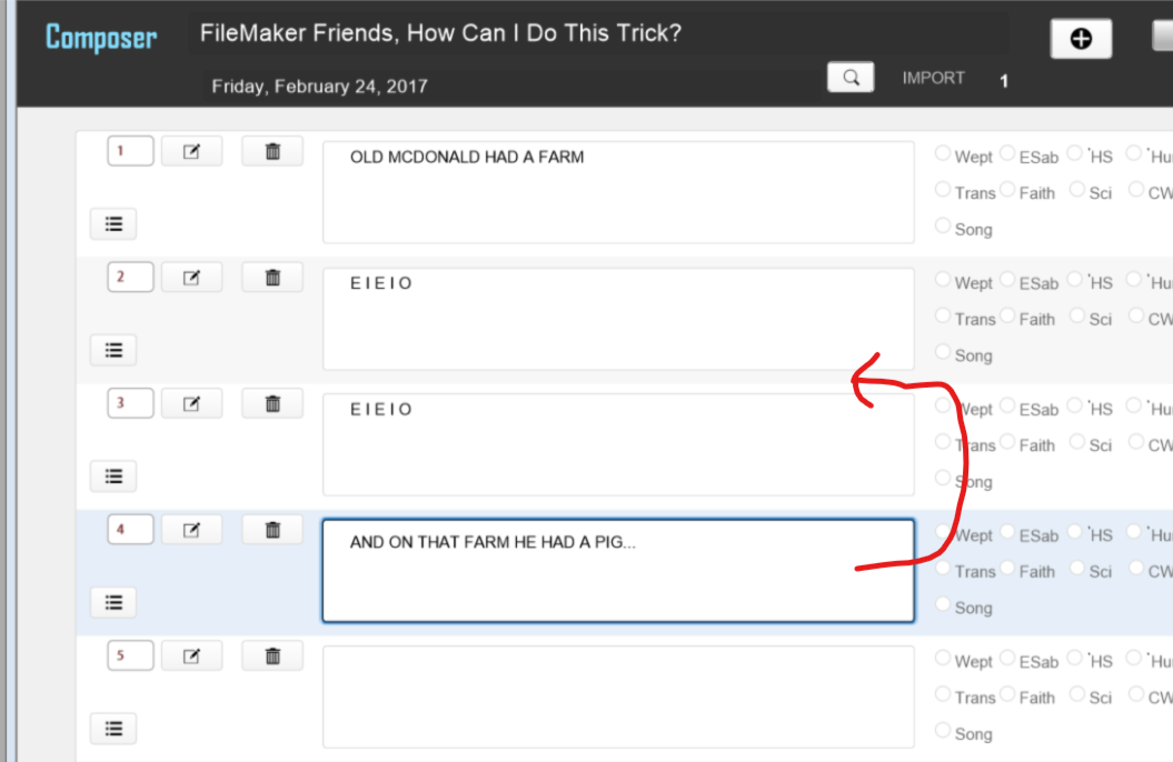

FileMaker friends, could someone please teach me a new trick
I'm building an interface for composing "counsel" documents with each sentence it's own related record
Sometimes I need to move the portal rows around, like in my "Old McDonald" example
I think they call this kind a thing a "custom search order"
Is it possible to "Drag and Drop"?  If not, no problem, how about a scripted button?
What would you do?
No, it is not custom search order. It is custom sort order. You could do web searches for drag and drop portal sort.
You will need to add sortOrder field (number field) to the child record table and you will need to sort the relation by this field.
To begin using it, have it auto-enter get(recordNumber). Edit it by hand to control sort. Then learn from the available example files how to automate this.
Drag and drop is sort of possible (see http://fmforums.com/forum/topic/67781-script-triggers-and-drag-drop-incompatible/), but far from being simple.
For a method using buttons, see http://fmforums.com/topic/60325-manually-reorder-portal-records/#comment-285451
Note that before deciding on any specific method, you need to consider whether reordering performed by one user should take effect for all users alike (which would also require that the records being reordered by one user will not be locked by another).
