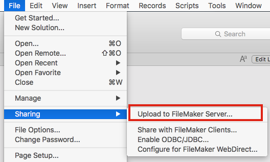

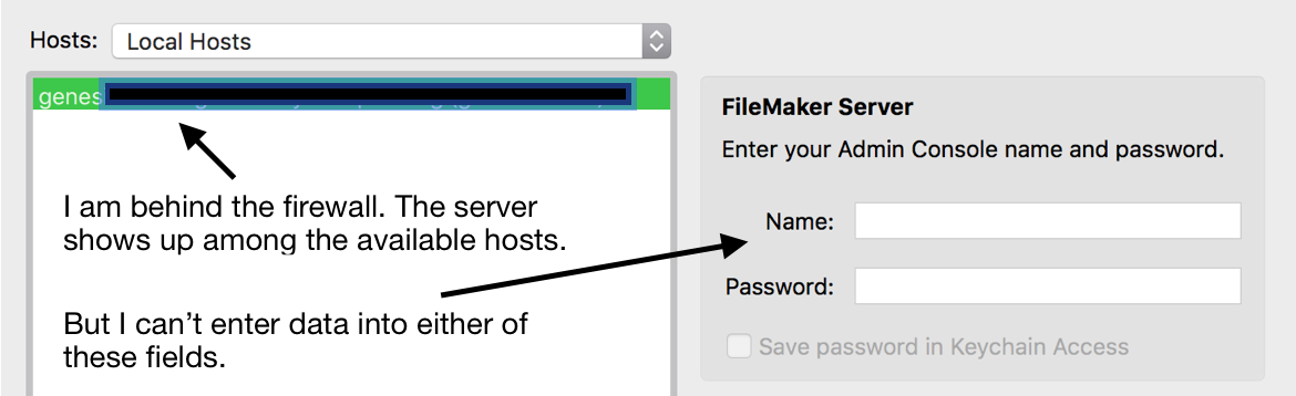

I am working from FileMaker Pro Advanced. I choose File > Sharing > Upload to FileMaker Server. I am presented with the Upload to FileMaker Server window. I select Local Hosts from the Hosts menu. My server appears in the left pane. I select my server. The right pane contains fields into which I am supposed to enter the Admin Console name and password. I am not able to enter either of these fields, and am consequently unable to enter my credentials.

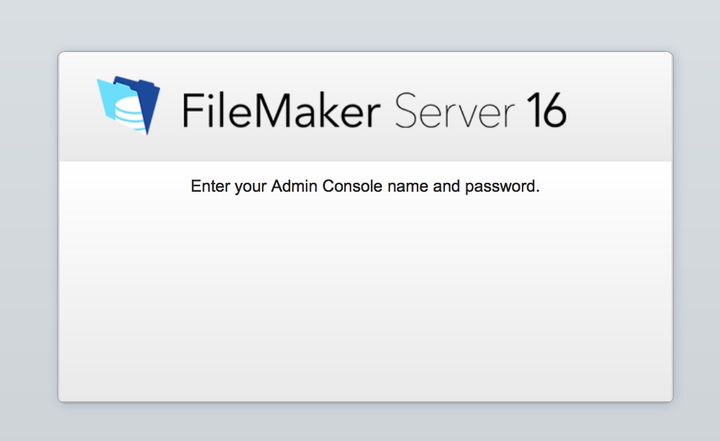

597ccde86d715_ScreenShot2017-07-29at1_01_44PM.thumb.png.cf81dfed4021679a21f6036084e774fa.png
Thanks for the link. It confirmed that the way I hosted the files was one of the correct methods. The files are accessible now, after the reinstallation of FMS, but the direct method of hosting is still broken.
It's not a browser issue. I can get to the console. The screenshot I posted was from FMA 16, not a browser.
